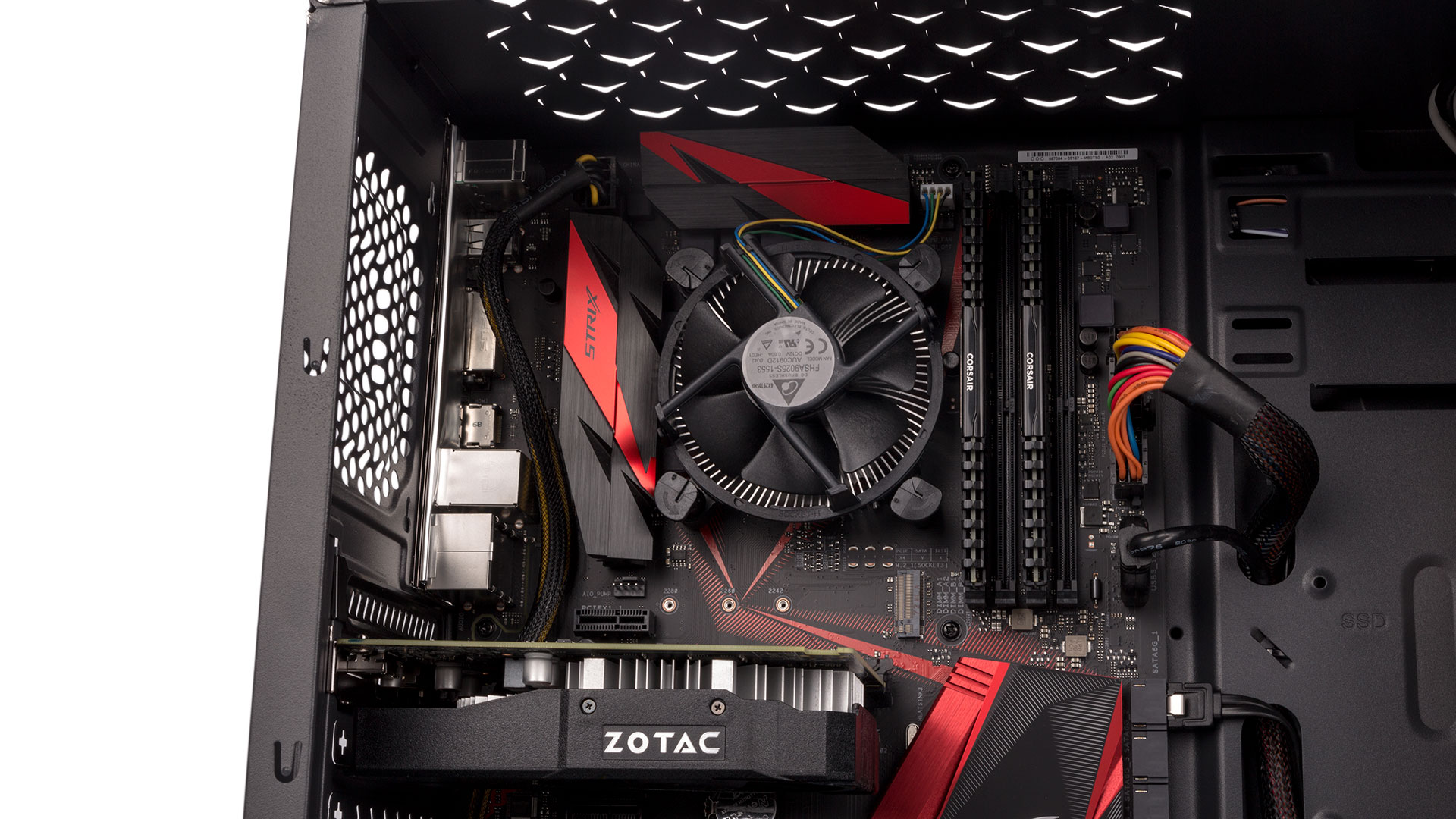

Stress testing threw up no concerns. Under full load, the CPU cooler fan hit 1,900 RPM, which was audible but not whiny or excessive, and the CPU stayed below 70°C. The GPU also stayed quiet and cool, boosting to around 1,700MHz under load. Even with everything loaded, power consumption remained firmly under 150W, and the PSU never sounded like it was struggling.
